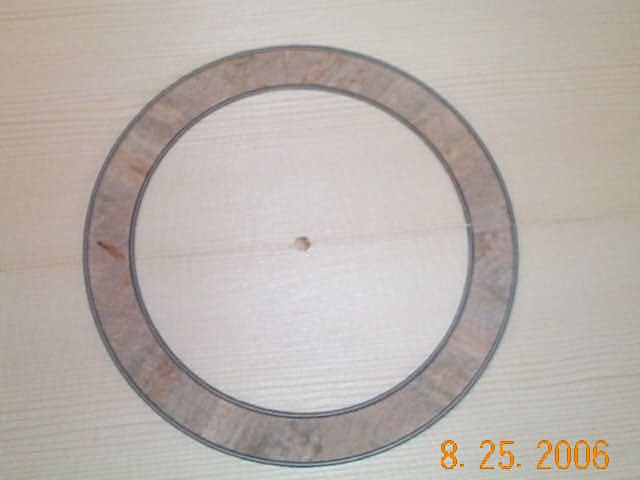

First, a pic of the almost completed 4 piece maple burl rosette. There was also to be an abalone ring in the center of the burl (glad it wasn't there already).

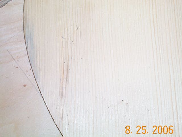

Here is a pic of the gouge that was left after the belt snapped.

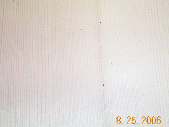

And here is a shot of some imbedded pieces from the sanding belt. These are now all over the lower bout of the top.

It depends on how thick your top is...have you tried scraping those sections and seeing how deep the gouge really is? If you have have enough thickness and have not braced it yet you may still be able to clean it up with a sharp plane or scraper.
If you can get the imbedded grit out you can also try wetting the top by spritzing it with a spray bottle and then putting a towel or wash cloth over a section and use an iron to try to raise the wood that was dented by the grit. It wont get all of it out but that and then scraping and/or planing (by hand) you may still be able to resurrect the top.

Shawn, thanks for the suggestions. Unfortunately, the top is just about .110 thick and the gouge is at least .018 deep. I am not comfortable going with a .090 top on a 12 string, even though the adi is pretty stiff. And it might be even thinner than .090 by the time the entire gouge is sanded out.

Dave, you may gain some room by steaming out the dents before finish sanding them. You will need to let the top sit a bit again after that to let the moisture come back out but it may make the top usuable on a future build. A clothes iron and damp cloth!

Any chance of flipping it over, installing a new rosette and saving it?

Paul, flipping it over is a great suggestion. Problem is, it's a cutaway and it has already ben rough trimmed to the cutaway shape.

Well, I sandes the top down until the gouge was completely gone and it was only .075 thick. I think I'm gonna shelve this one and use it on a smaller guitar that I'm planning to build.
